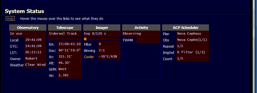

Posted: 2013-02-02 20:42:42
by Robert
- Capture3.PNG (30.67 KiB) Viewed 8075 times
Nu fotas den med....
