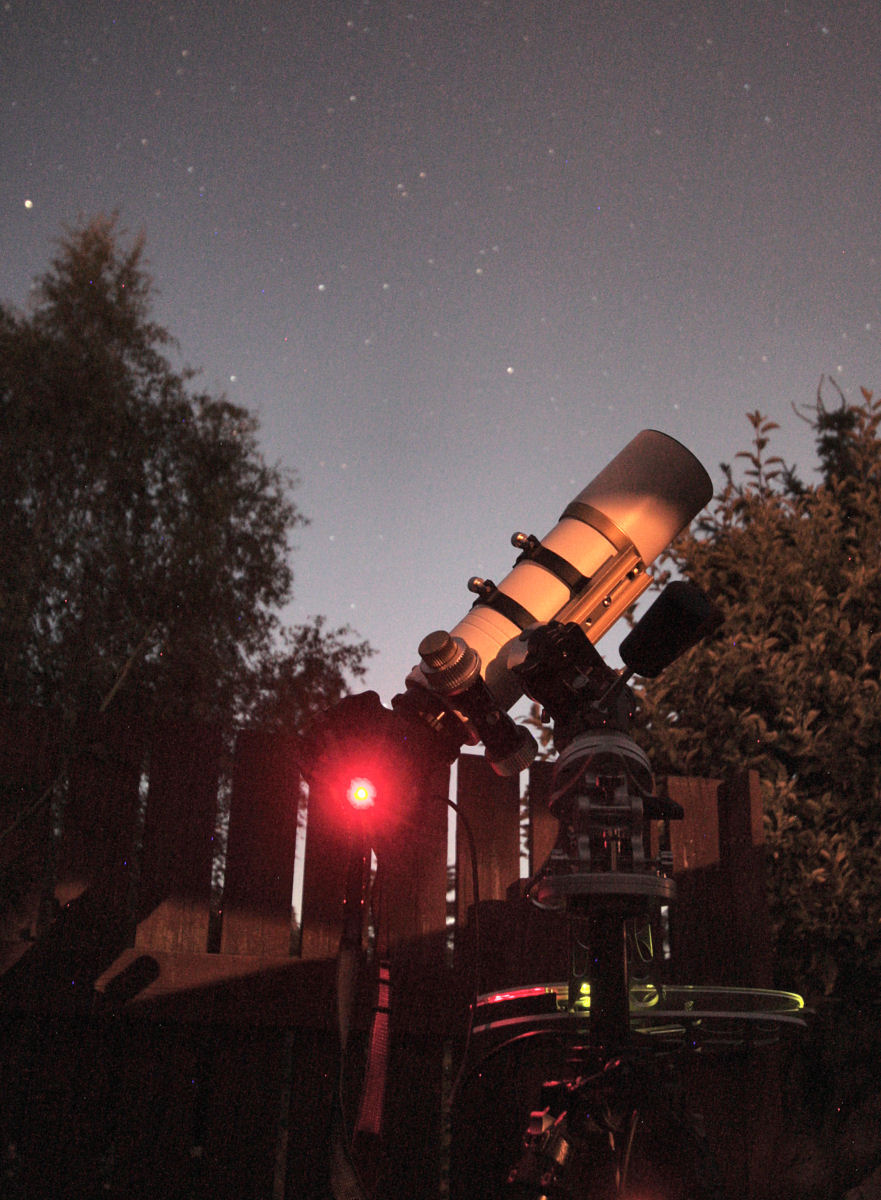

As I had bought this astrograph mainly with a thought as traveling scope in mind, I was of course eager to know how it would work on my Astrotrac with a Canon 5D MkII so this was to be my 1:st test.
Putting the package on the Astrotrac, presented of course no large problems. Just the ordinary balancing issues.

Attached are my first two images together with a picture of the setup used during the evening..

- Astrotrac mounted on a Manfrotto 055B tripod. Canon 5D MkII mounted on the Star 71 astrograph.
